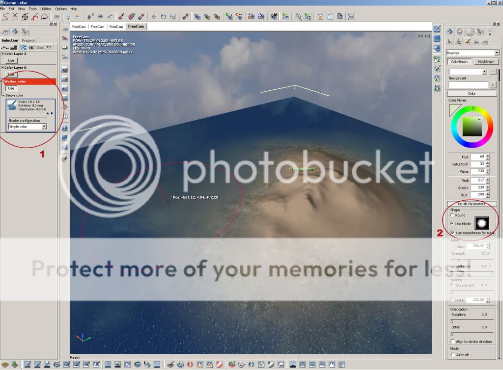

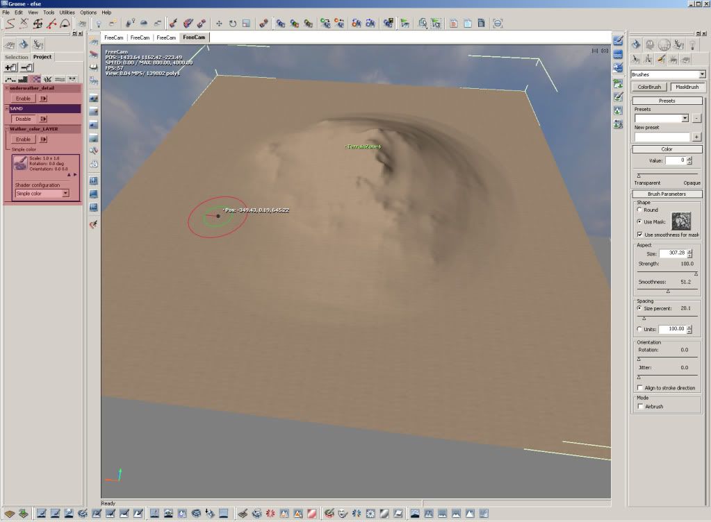

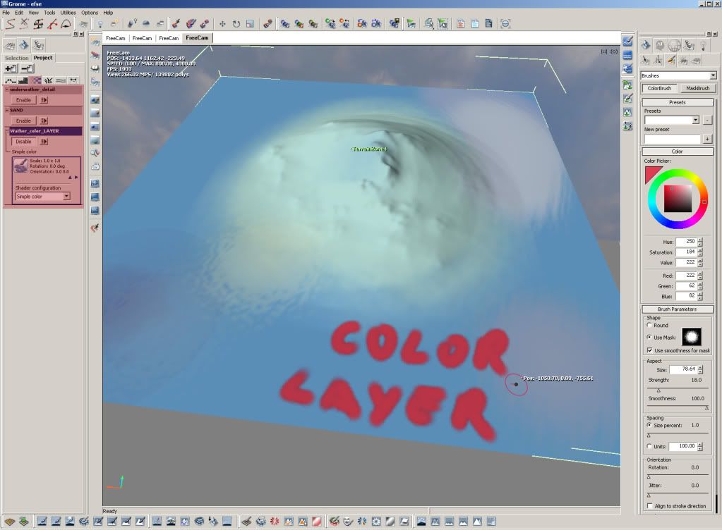

Mihai
PostPosted: Mon Aug 10, 2009 3:02 pm    Post subject: Reply with quote
Joined: 26 Jan 2007
Posts: 85
Hi,
No You no need the second layer of water.. but in order to paint the water..you need a color layer...set as a simple color shader .. (pls see the video tutorials very characterful ..or read the help..)
The color layer is a texture layer without the mask..it contain the color which you can paint..with a brush or generated..but it's better with the brush..you will have more control this way..and beside it's more fun Smile

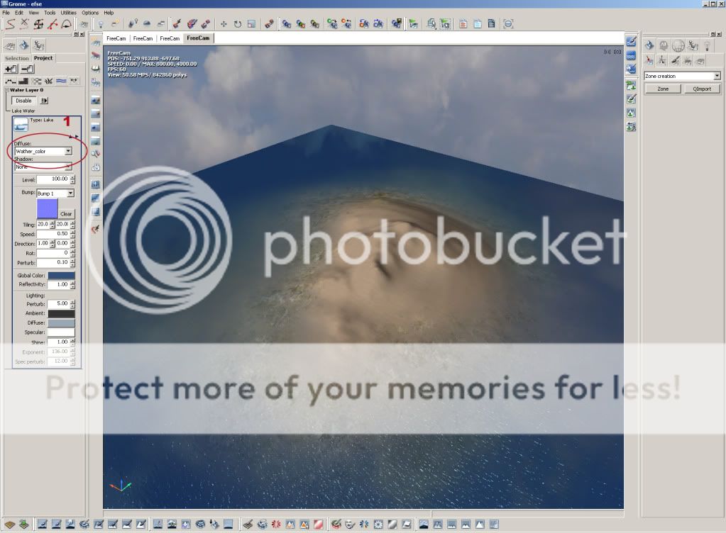

lostbetween
PostPosted: Mon Aug 10, 2009 3:13 pm    Post subject: Reply with quote
Joined: 16 Apr 2009
Posts: 94
ok, opening up the tut now. In the meantime, I don't appear to have the diffuse setting you are showing above:
http://spooningmoons.com/Becca/Grome/diffusesetting.png
yup, the tuts show a water color in the diffuse and I am not seeing it on mine.

Mihai
PostPosted: Mon Aug 10, 2009 3:43 pm    Post subject: Reply with quote
Joined: 26 Jan 2007
Posts: 85
that's because it's a color layer that you have to create..as a simple color
A color layer- it's a layer of color...(without a mask)

lostbetween
PostPosted: Mon Aug 10, 2009 3:49 pm    Post subject: Reply with quote
Joined: 16 Apr 2009
Posts: 94
yeah i think thats what I figured out. I used color modulate and then the layer name showed up in the diffuse column. But you are saying to use simple color so I am not assigning to selection right.

Mihai
PostPosted: Mon Aug 10, 2009 3:55 pm    Post subject: Reply with quote
Joined: 26 Jan 2007
Posts: 85
Color layer you shout put it under all the layer... you will use it only for the color of water or vegetation..
